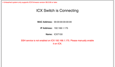

Is this what I should be seeing? I am sure that the MAC ID should not be zero

Hi @nanners02
I 100% sure, the code you are running in this switch is old, so SSH is not enabled, this is why you cannot see the MAC address, please follow up the steps I have provided from #2.

Again, asking here, is the screenshot I sent of the switch MAC ID i sent, is it normal?
Even if the code is old should I not be seeing this ID?
