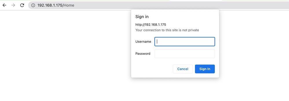

After a power outage the switch did not rebooted. Manually rebooted and now the internet is SUPER slow and not routing to the AP's. The signal is weak to the point the ring doorbell and cameras are not getting signal. How do I get this resolved?

the username and password combos do not work.

This doe not work.
Again, the password in any combination is not working either. I have also paid to bring someone out from outside and we are still with no operable switch or access points.

Hi @nanners02
Try the same credential you used for Unleashed APP/Unleashed dashboard, if still not working, you need to gain access via console and perform a password recovery.
Note: take in consideration that the user either super or admin, both are lower case from the bundle we have provided
1:try the same credential as Unleashed APP.
2:If still not working, gain console access to the Switch.
