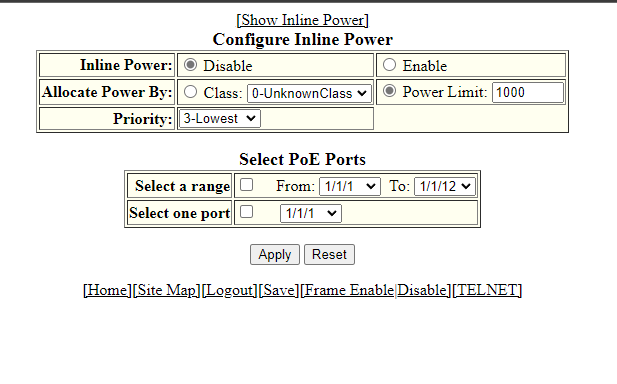

Supposed to be Disabled?Supposed to be Disabled?
Hi @MiSNemesis
Could you please enable, apply, save and check once? (Please refer to the below screenshot)
