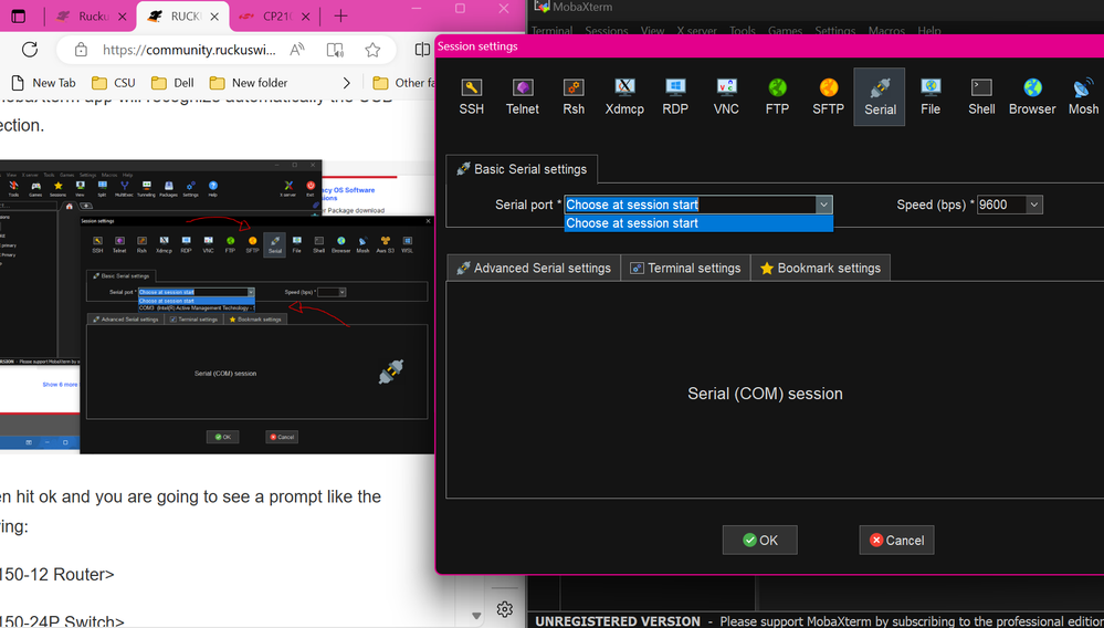

I have a dell XPS laptop that does not have an ethernet port. I tried to connect to the switch using a usbc and a usbc type docking station with ethernet however, the switch did not connect as I have watched it do in the support videos.

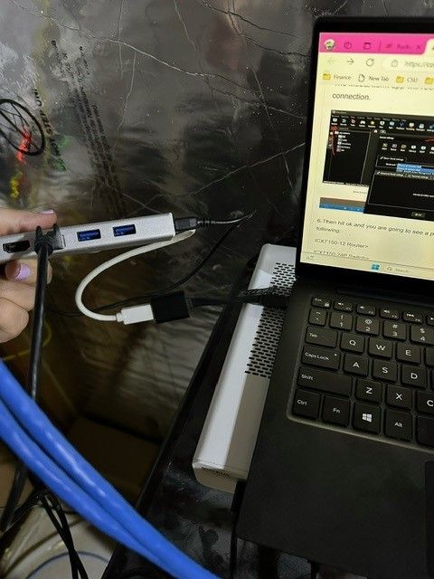

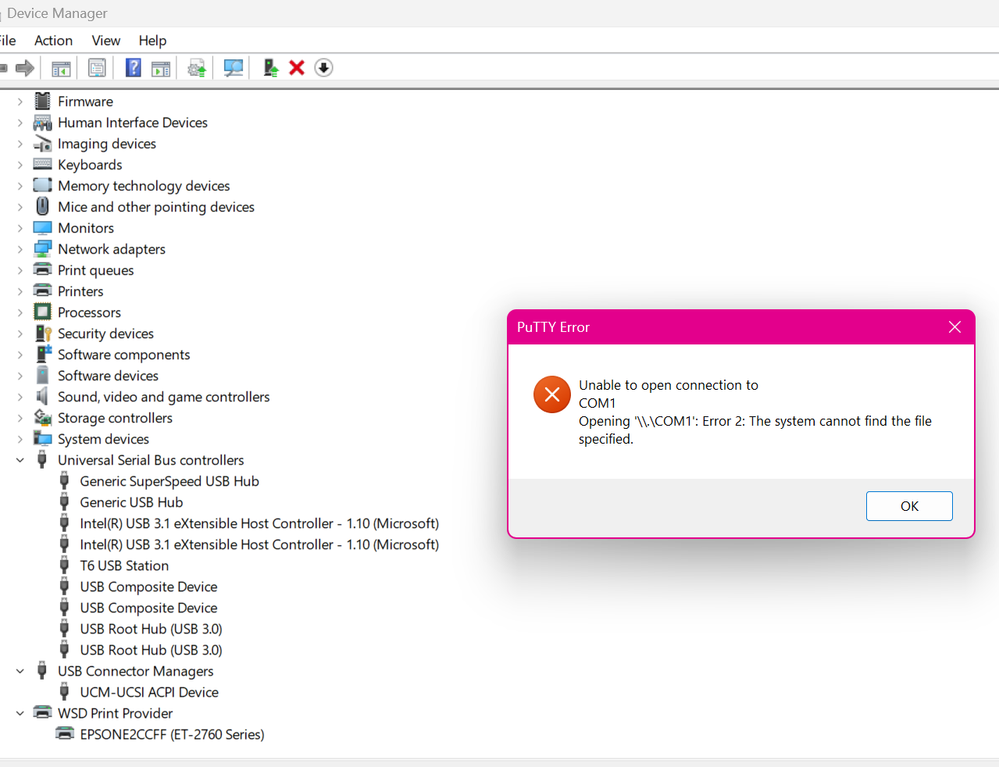

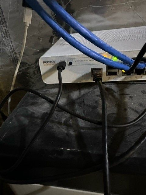

Hi @Mad-Lennar-Cust
Could you please share a picture showing a software recovery cables connection between the laptop and the Switch? Also a screenshot of Device Manager showing the COM port details.
Also could please let me know if you install the Switch drivers on your laptop? If not, please install the below mentioned drivers.
To access by console CLI, you must install a driver so that the workstation/pc/desktop or laptop can recognize the cable
Make sure to download the zip drive for the file below & "extract all". Once it's extracted, run the file ,driver should be installed.
Link:https://support.ruckuswireless.com/software/1414-brocade-ruckus-7150-usb-serial-driver-windows
Link: silabs.com/developers/usb-to-uart-bridge-vcp-drivers?tab=downloads
