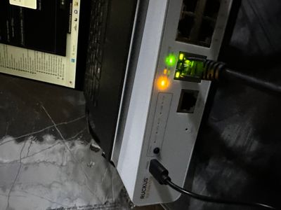

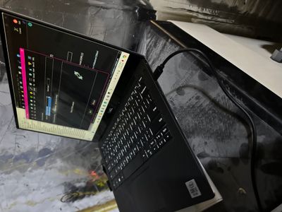

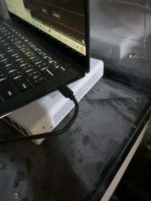

I am unable to factory reset my ruckus 7150 C12 switch. I followed the forum steps and tried to reset 15 times today (this is in addition to the 10+ times I have tried in the last year). I have reviewed the recommended solution to be, replace the device. How do I proceed with the support?

Hi @Mad-Lennar-Cust
Based on the troubleshooting done, your ICX-7150-C12P Switch’s Console ports are not responding. Tried different Troubleshooting steps however, the failure persists, and unable to perform the software recovery on the Switch that is stuck in the boot mode. This Switch unit Should be RMA (Return Merchandise Authorization) in simple words replacing it.

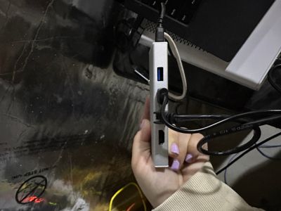

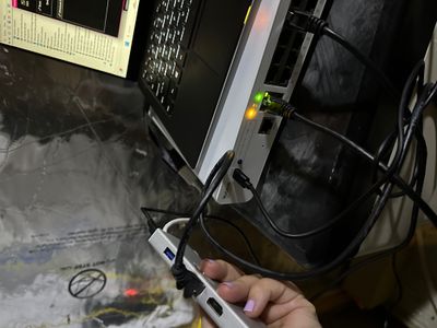

this cord went from ruckus to laptop

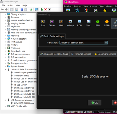

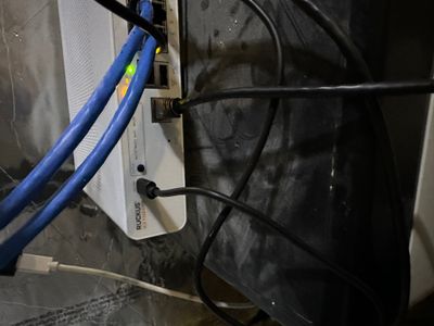

Could you please let me know if you connected the other ethernet cable to the correct port of the Switch and tried? As explained in my last post. If not, please try.
I moved the ethernet to the location suggested and kept usbc to usbc, i also tried a usbc from ruckus to usb adapter to the docking station that the ethernet is plugged into. No luck on either.
I tried this (response below) what do i do now?
