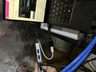

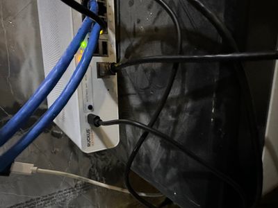

I have done all of these things (see reply below) I have been dealing with this problem for an entire year. I am so distressed and disappointed in this product.

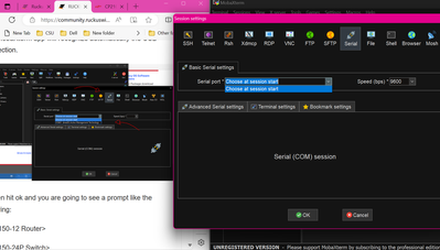

Confirming these steps were performed with no success, the ruckus device is not recognized.

Hi @Mad-Lennar-Cust
Please make sure to use the USB-C (there is no USB type-C connected to the dock station in the picture) and Ethernet cable (RJ-45) together to connect to the dock station.
As I see from the screenshot, your ethernet cable plugged into the incorrect port on the Switch panel. It should be plugged into the correct port as marked in the screenshot below. Please use ethernet cable (both ends RJ45 plugs) and USB to type C cable both together as described in steps 2 & 3 in the guide link. I request you follow the same and perform the software recovery process once again.
Thank you again for your patience and understanding
04-18-2024 08:17 AM
I apologize I forgot to include that photo in my reply, the USB-C was connected directly from the ruckus to my laptop. I did not use the docking station for this connection.
