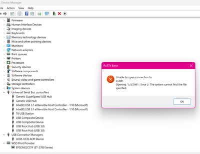

I am unable to factory reset my ruckus 7150 C12 switch. I followed the forum steps and tried to reset 15 times today (this is in addition to the 10+ times I have tried in the last year). I have reviewed the recommended solution to be, replace the device. How do I proceed with the support?

Based on the troubleshooting done, your ICX-7150-C12P Switch’s Console ports are not responding. Tried different Troubleshooting steps however, the failure persists, and unable to perform the software recovery on the Switch that is stuck in the boot mode. This Switch unit Should be RMA (Return Merchandise Authorization) in simple words replacing it.

Hi @Mad-Lennar-Cust
Please make sure to use the USB-C (there is no USB type-C connected to the dock station in the picture) and Ethernet cable (RJ-45) together to connect to the dock station.
As I see from the screenshot, your ethernet cable plugged into the incorrect port on the Switch panel. It should be plugged into the correct port as marked in the screenshot below. Please use ethernet cable (both ends RJ45 plugs) and USB to type C cable both together as described in steps 2 & 3 in the guide link. I request you follow the same and perform the software recovery process once again.
Thank you again for your patience and understanding
 I apologize I forgot to include that photo in my reply, the USB-C was connected directly from the ruckus to my laptop. I did not use the docking station for this connection.
