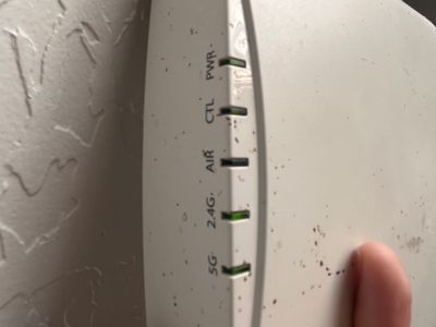

- Was this working before or is it a new installation?
- May I know how many Access Points are connected to the Switch? Could you please let me know the light status on the Access Points? Any of these lights are on (Please refer to the below picture and share a picture of the same)
Please help us with pictures of your Access points showing the status of the lights

It had been working well for the past few years with no issues before the recent outage.
We have 2 wireless access points and 2 ethernet access points that are wired to the switch.
On the upstairs wireless AP, 5G is orange. 2.4G is green. No lights on Air or CTL. PWR is Green.
On the downstairs wireless AP, 5G, 2.4G, and PWR are all green. CTL has a faint green (but I think that is the glow from the PWR light. AIR has no light.
