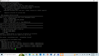

Please perform the below commands and share the output to check and confirm your current version on the Switch.
show version
show flash
09-06-2023 08:43 AM
09-06-2023 08:50 AM - edited 09-06-2023 08:51 AM
Hi @Jyothik16
Great!!! As I can see from the screenshot you shared, your RUCKUS ICX-7150-C12P Switch is now upgraded to a latest UFI version.
