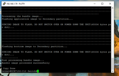

I followed the steps as per this link.
finished until this step. And to follow for further steps I am getting below error
now internet is also not working

I could finish all the steps.
how do I check ? now everything is upto date
