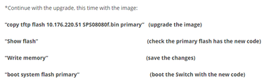

I followed the steps as per this link.
finished until this step. And to follow for further steps I am getting below error
now internet is also not working
09-05-2023 07:29 PM
I could finish all the steps.
