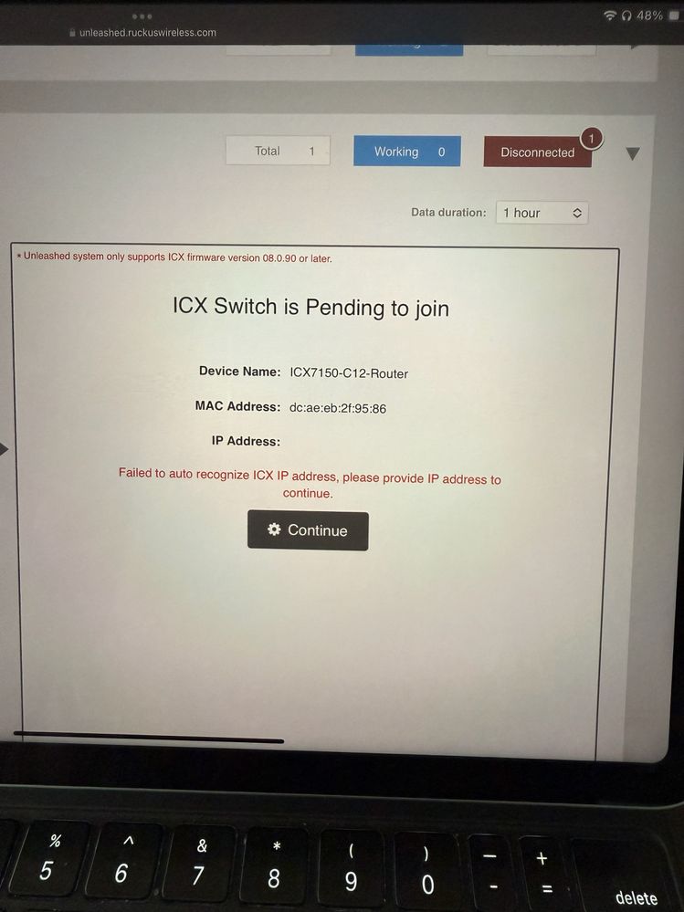

We had a power outage and the internet seems to go on and off.  We have a ICX7150-c12p-2x1g switch and 2 R350 access points.  Lights are green on the switch and all lights are green on the access points except the AIR light, which has no light on.  I have access the ruckus unleashed app and the two access points show up as good but the switch says it is pending and no IP address identified.  I have used the advanced scanning tool and the IP address is not coming up for the switch, but the two AP do show up.  Any suggestions, do a switch reset?

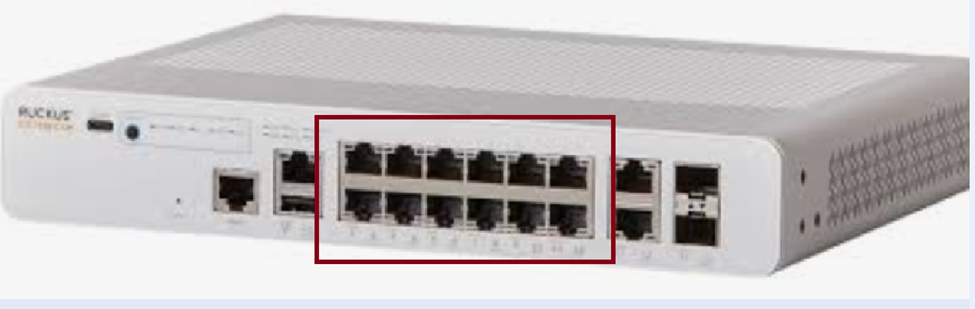

From the pictures you shared, it seems that the cable connections look normal.
I would request you to please remove the ISP cable from the Switch and try to re-connect to any of the other 12 ports on the Switch.
Please try to scan and check if you are getting the Switch IP address and in the Unleashed browser as well.

ruckus switch no ip.jpgSo I am still unable to see the IP address
