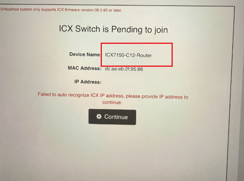

We had a power outage and the internet seems to go on and off.  We have a ICX7150-c12p-2x1g switch and 2 R350 access points.  Lights are green on the switch and all lights are green on the access points except the AIR light, which has no light on.  I have access the ruckus unleashed app and the two access points show up as good but the switch says it is pending and no IP address identified.  I have used the advanced scanning tool and the IP address is not coming up for the switch, but the two AP do show up.  Any suggestions, do a switch reset?

Hello @vwstrauss ,
From the picture you shared, I see that the Switch is running on the Routing code (SPR). The Switch should run on the Switching code (SPS) for Lennar home users. Due to a power outage/power spike, the Switch boots up on the other partition which may be running on a ‘Routing Code’ results in causing this issue.
As you are not getting the IP address of the Switch even after changing one of the 12 ports on the Switch, I would request you to please connect to the CLI of the Switch using the console cable.
Please follow the below RUCKUS Lennar Knowledge base self-help article which will help you to console in the ICX-7150-12CP 'Ruckus Switch
Once you have access to CLI using the console cable, please use the below RUCKUS Lennar Knowledge base self-help article which will help you to fix the issue when the Switch is running in the Routing code.

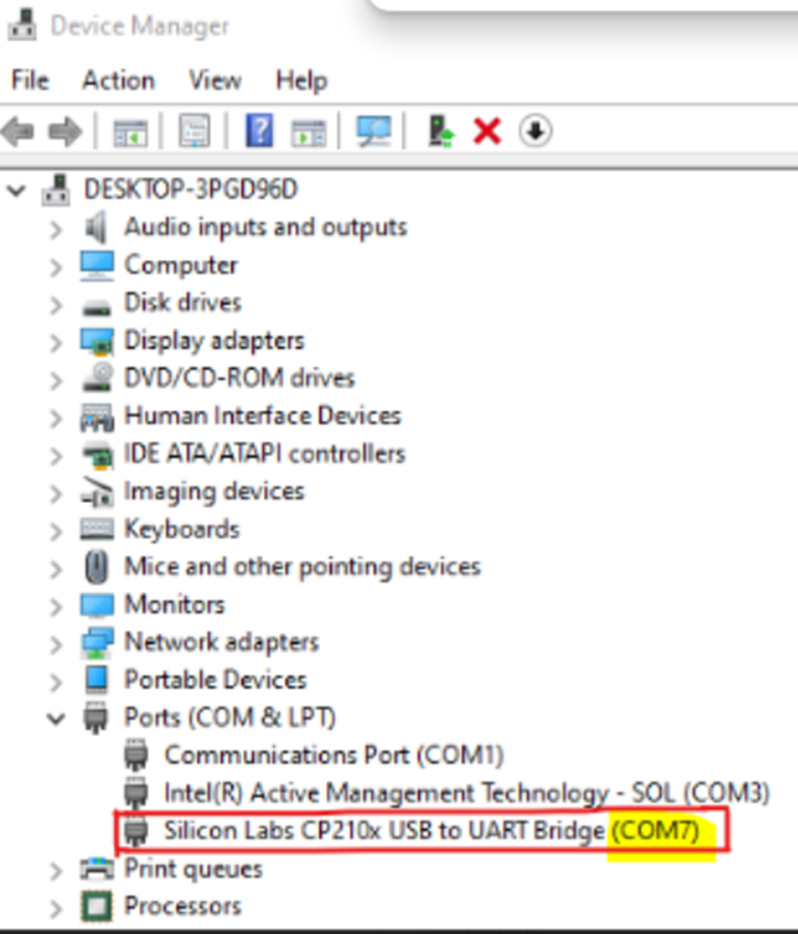

Once again, please make sure to download the zip drive for the file below & "extract all". Once it's extracted, run the file, the driver should be installed using the 2 links below.
Link 1: https://support.ruckuswireless.com/software/1414-brocade-ruckus-7150-usb-serial-driver-windows
Link 2: silabs.com/developers/usb-to-uart-bridge-vcp-drivers?tab=downloads
Could you please restart the laptop after installing the drivers and check the COM port details in the Device Manger from the Control Panel?
COM port details should be with the silicon lab name in the device manager.
