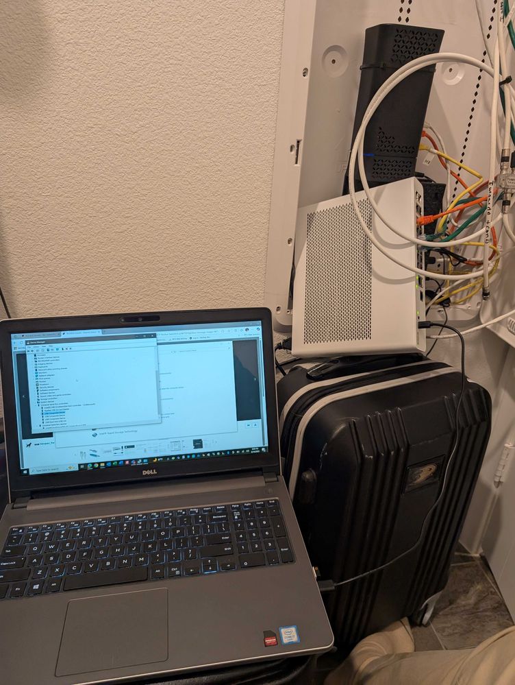

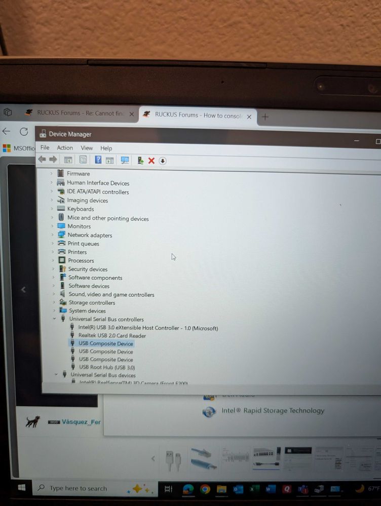

So I had everything lined out. I had downloaded the driver to recognize the connection, I had downloaded the Putty app, I had typed out all the instructions. I followed them just as they said. I had extracted the driver files and saved them to my computer.
But, could not get it to recognize the connection. Device manager did not show ports so if the connection had been recognized, i still could not put the correct Comm #.
I am very surprised a company like this does not have automatic updates and fixes. When older people purchase a Lennar home, these type of incidents would be terrible, if they had ever got it to work in the first place. Ours did not, we still have to pay for a wireless router from the cable company and connect that to the switch instead of just going from their service box.
Anyways not sure what to do now. Not sure why the connection would not work. I have attached pictures to show you my set up.

If u look closely at the picture I did send it has my computer sitting there with a USB cable plugged into it, and the other end is the switch with the USB c cable plugged into it. Do you need a different picture?

Hello @vwstrauss ,
Thank you for the response and for sharing the screenshots.
Once again, please make sure to download the zip drive for the file below & "extract all". Once it's extracted, run the file, the driver should be installed using the 2 links below.
Link 1: https://support.ruckuswireless.com/software/1414-brocade-ruckus-7150-usb-serial-driver-windows
Link 2: silabs.com/developers/usb-to-uart-bridge-vcp-drivers?tab=downloads
Could you please restart the laptop after installing the drivers and check the COM port details in the Device Manger from the Control Panel?
COM port details should be with the silicon lab name in the device manager.
