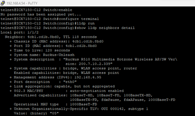

Here is the information
Hi @ah07
Everything looks fine. At this point, we may need to factory reset the APs. Please follow the below process to factory reset your APs to configure them with a new Wi-Fi Network/SSID.
IMPORTANT NOTE: To perform a factory reset correctly on one of the access points, you must disconnect the rest of your other access points from the "ICX-7150-switch". For example, if you have 3 access points, you should go to the switch and disconnect 2 of the cables to turn off the "2 access points" and only leave 1 connected with which we are going to work the factory reset once you configure the access point and make sure all is good, go ahead and reconnect the other Access Points back.
As you have 2 R510 Access Points in your setup, remove the cables of any ONE Access Point, and perform the factory reset only on the ONE connected access point. Once you complete it, connect the unplugged Access point cables back to the Switch ports and it will sync up with the configurations from the factory reset Access Point.
