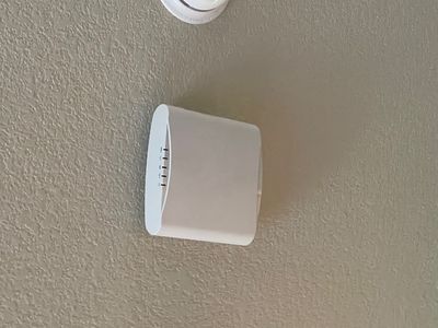

Access point #1 with no lights.

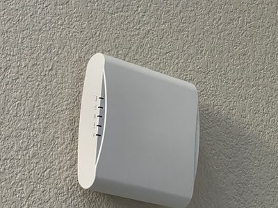

Access point #2 with no lights

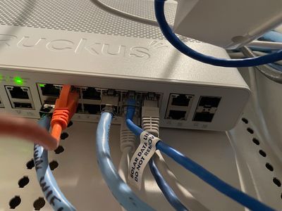

View #1 of the ruckus plugs.
View #2 of the ruckus plugs and lights.
It is difficult to get better photos because the ruckus is attached to an electronics closet and I am unable to remove it or move it. If there are different photos needed, please let me know.
