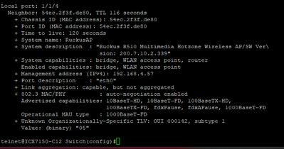

I need some help troubleshooting my access points that are no longer working. Wifi has become slow and in some places throughout the house non existent.
Product Name: 12-PRT POE+ COMP 2X1G SFP+

Here is the information
11-29-2023 09:17 AM
Hi @ah07
Everything looks fine. At this point, we may need to factory reset the APs. Please follow the below process to factory reset your APs to configure them with a new Wi-Fi Network/SSID.
