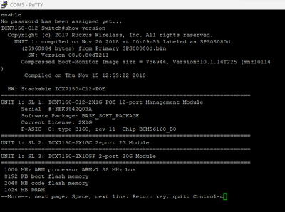

So I was able to get this far...
I was following another thread. I had to connect via cable access as the IP step wasn't working. But this step in Putty is showing Primary so I am unable to continue with the information from the other thread.
What would be my next step from here?

Hi @ah07
Thank you for the response and the information you share.
As I can see from the screenshot you shared, your Switch is on an older 08080d non-UFI version, We suggest you upgrading the Switch to a latest stable version.
Please follow the below steps explaining the Upgrade process.
The recommended stable version is 8095g (08.0.95g)
The Upgrade path would be: 08080d (your current version)>>8080f>>8095g
(PLEASE NOTE: IGNORE 8095h and use 08095g patch in place of 8095h as explained in the guide)
Your Upgrade folder should contain these 3 files shown in the below screenshot: (Refer the guide link for more information)
Below are the options or methods to perform the Upgrade on the switch: You could choose any one of these.
1st Option:
1. In this option, we will use a pen drive or USB flash drive in which we move the files to the pen drive and connect it to the Switch then through CLI we execute the commands to upgrade the Switch using the following guide as a reference:
2nd Option:
2. The following guide is an example of an upgrade via TFTP server, by using an application (FREE) to send files or upload remote files to a device, in our case, we will use it to update a new version to the Switch, basically it will send the image version remotely from the computer to the switch.
3rd Option:
3. In this option we Upgrade the Switch from the Web Interface (GUI) of switch.
https://0.0.0.0 or http://0.0.0.0 (IP address of Switch. 0.0.0.0 is just as an example)
As you can access CLI/Console, I would suggest you follow the 2nd option.

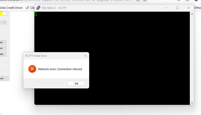

Hello,
I am trying to upgrade via option 2. However when I try to connect via Putty I keep getting this. I've tried both SSH and Telnet. I cannot connect.
What would be the next steps?
