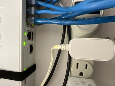

Perhaps from a power outage, the APs have lost power and internet from Ruckus switch. Doorbell (ring) dead.
