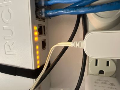

Perhaps from a power outage, the APs have lost power and internet from Ruckus switch. Doorbell (ring) dead.

As I can see from the picture you shared, there are lights on PWR and SYST, if there is an amber/orange light on the "SYST" and a green light on the "PWR" on the Switch (as it is in the below picture). Meaning the Switch is stuck in the boot mode.
Basically, due to the power outage/ power spike, the switch went to a state that we call ‘boot mode’ that is not able to boot up properly.

I tried this multiple times. The amber lights across the panel remain blinking for ever and don’t come out of that loop.

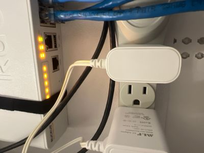

attached is after about 30 min. Still blinking. This is #13 th attempt.
Hi @Karupasu
Apologies, if reset with a paper clip doesn’t work, we must proceed with software recovery of the Switch. Please unplug all the attached ethernet cables from the Switch ports and connect software recovery cables with power cord, proceed with the process.
