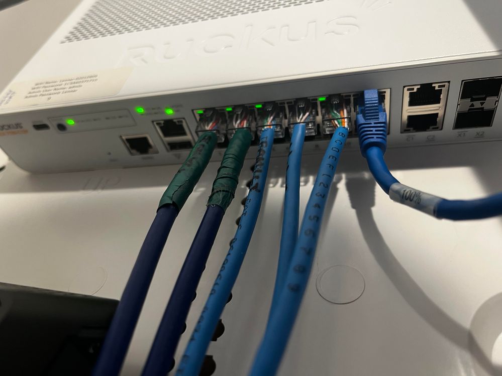

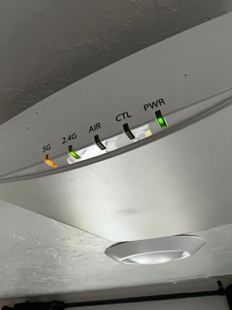

3. May I know how many Access Points are connected to the Switch? Could you please let me know the light status on the Access Points? Any of these lights are on (Please refer to the below picture and share a picture of the same).
08-22-2023 01:13 PM - edited 08-22-2023 01:17 PM
1. There are 6 ports plugged in and 4 are green.
2. Yes, the internet is working. I confirmed with WiFi and hardwiring a laptop.
3. There are 2 AP connected.
pictures are attached.
08-22-2023 01:16 PM - edited 08-22-2023 01:18 PM
The picture of the AP with the green CTL light is upstairs (furthest away from the Ruckus board). The picture of the AP without the CTL light is downstairs (right next to the Ruckus board).
