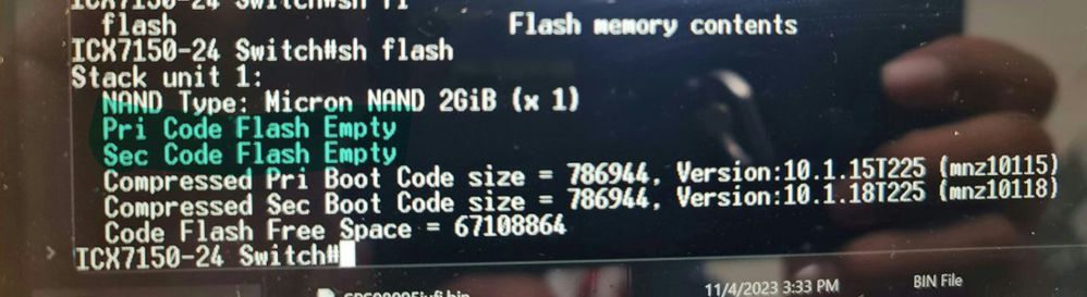

07-25-2023 05:49 PM
hi..i already do this...ALL IS OK...but refer to image ...code flash empty..how to insert ya?

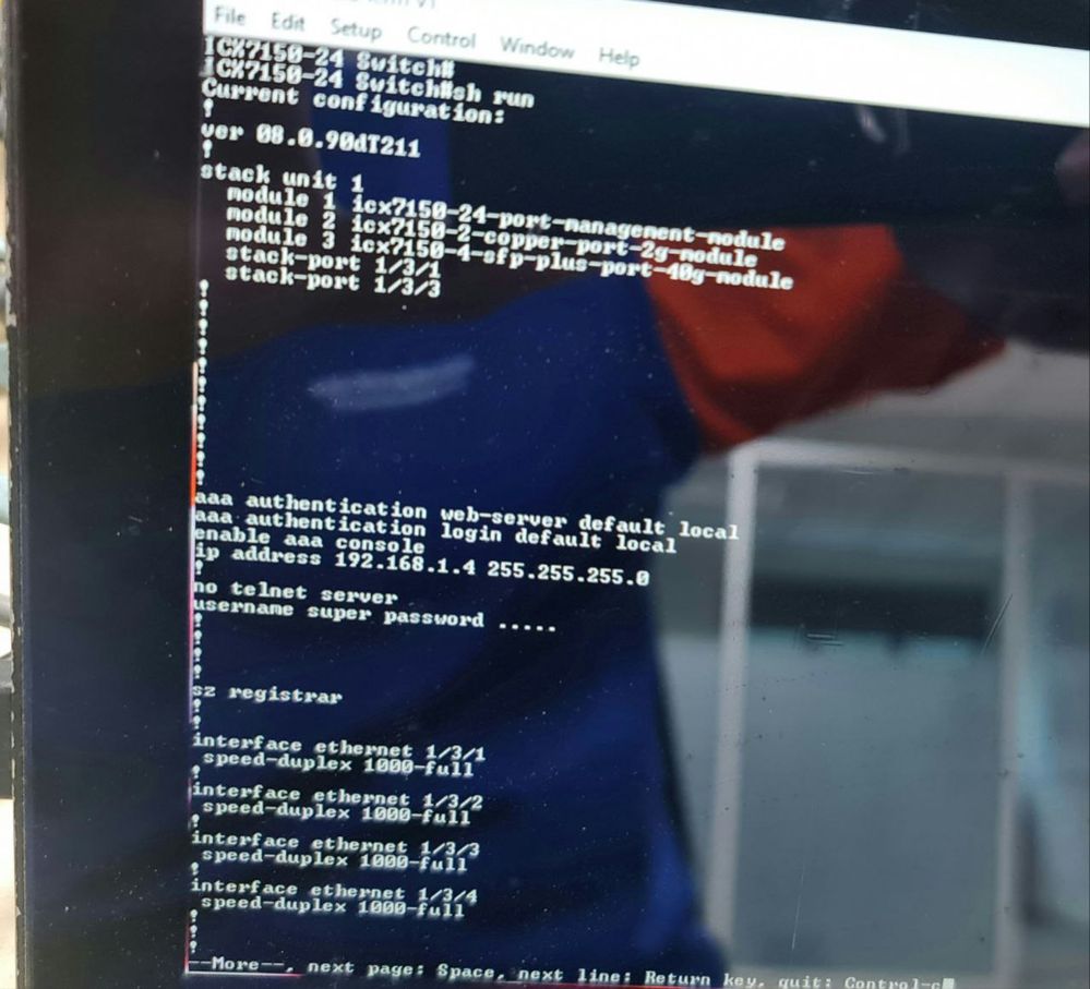

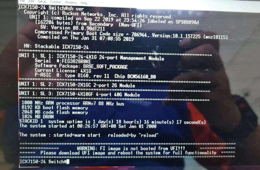

07-26-2023 08:07 PM - edited 07-26-2023 08:08 PM
hi bro..i'm not from lennar homes....below are pictures of sh run and sh version
sh version :
sh run :
