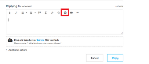

If you facing any issue or seeing a error when you follow any steps in the link. Please upload the picture of the error using the below option
Also please upload the picture of front panel of the switch using the above option .
