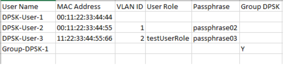

I would like to create DPSKs with specific passphrases in the internal database of my Unleashed R850. I cannot use the passphrases randomly assigned by the DPSK batch generation tool. Unfortunately, I've been unable to find a way to specify the passphrase to use when creating a DPSK. Any assistance would be much appreciated.
04-28-2021 07:23 AM
It looks like this can't be done using Unleashed at this time.
I found the exact equivalent feature I am looking for documented here, SmartZone Administrator Guide, 5.2.1 - Importing Dynamic PSKs.
I tried following these instructions on Unleashed, but the only undocumented part I could verify works is the VLAN ID. The rest I could not get to work, including the passphrase.
I've been evaluating Ruckus Unleashed for a site requiring 15 access points. Sadly, this is the only feature missing.

I am familiar with the DPSK sample profile and the absence of a passphrase in it, but I was hoping maybe there was another way I just hadn't found yet.
Are you implying this is the only way to create DPSKs and therefore it is not possible to specify the passphrase used when creating a DPSK?
