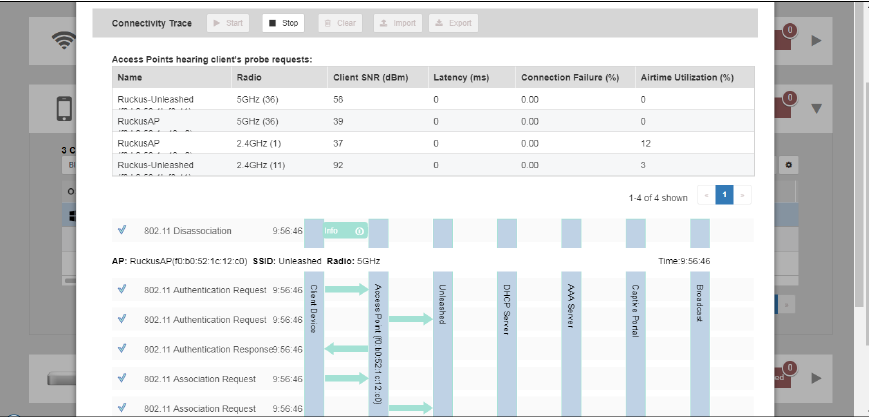

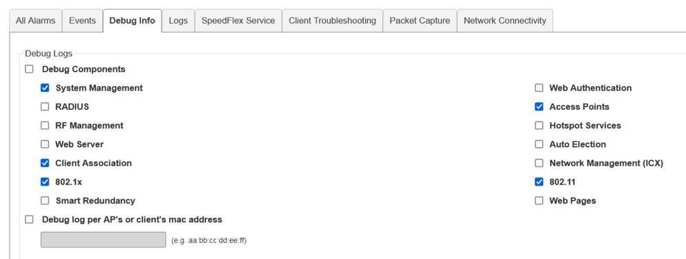

Hi All,
I'm working on this issue, can one of you provide me the below logs which will be easier for us to diagnose the issue?
1. Go to Administration >> Diagnostics >> Debug Info >> Check the "Enable Debug Components >> Select all the components >> Click on Apply >> . If you have more APs, then just enable below components.
2. Try connecting the client and reproduce the issue.
3. Go to Administration >> Diagnostics >> Client troubleshooting >> Locate the client >> And click on Start.
4. Once the issue is reproduces, click Stop and Click on Export icon.
5. Go back to Debug Logs tab, click on Save debug logs.
Please share both the files so that we can check.
