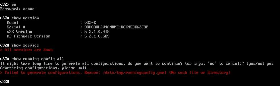

After installing ova on vsz5.2.1, use the command, show service, prompting all services are down , what should be done

Hi there, it usually take about 30-40 mins for all services to resume. If it is taking longer than 1 hour, something is wrong 🙂

I have noticed that once you complete the firmware upgrade, first thing resume is ICMP. If you can ping it, you can SSH into vsz and wait for services to be resume. I would wait for all the services to resume before proceeding further. 30-40 mins minimum.

After installing? did you run setup? and configured the vSZ?

I have run setup, and there is this prompt
