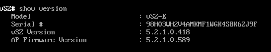

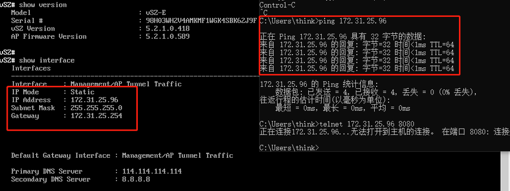

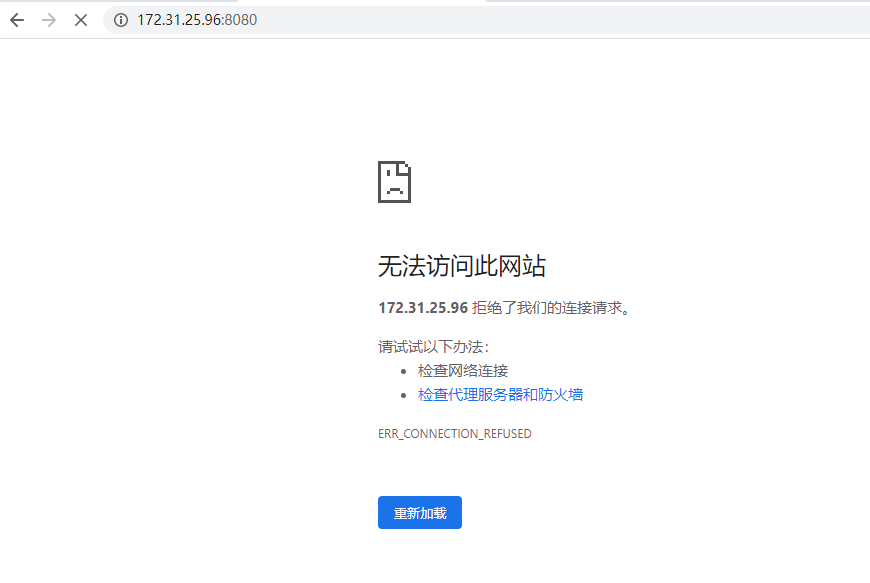

12-06-2020 06:14 PM
After installation, the setup and management address have been set, but now the WEB management page cannot be accessed using this address
