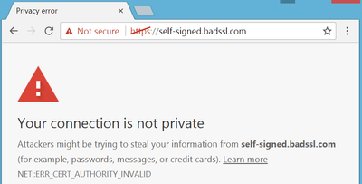

Hello, if you use a self-signed certificate, you may expect a security warning when you try to access your vSZ GUI and also for your WISPr users, they will not be redirected smoothly to the WISPr page and some devices maybe not even able to reach your WISPr page due to security risk.
Example of error message:
