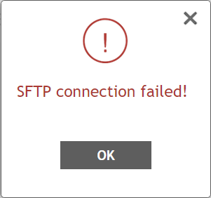

I'm trying to get SFTP working with vSmartZone.  I thought I might have fat fingered a setting, but not knowing what that would be, and deleted the VM of vSZ and reload.  I get the same error message on a fresh install.  the message reads:
SFTP connection failed!
Image_ images_messages_5f91c3f4135b77e2478f8fd2_3f08428f4fd01164902ad1f72976858a_RackMultipart20200430303761ggb-d683fec9-8166-4a34-90f9-b43eab02b94c-1566113106.PNG1588290196

Hi John,
AFAIK, by default vSZ firewall is not enabled, hence vSZ will not block anything until you enable firewall and configure rules.
Could you try hitting your SFTP server (IP:port) from the same subnet as vSZ's and see if you get a response.

Hi Syamantak ,
I was able to get to the SFTP server from another server on the same subnet.  My workstation is on a different sunbet and i'm also able to get to the SFTP server.

Hi John,
Please reach-out to support with debug logs from controller and they will be able to troubleshoot further.

One more detail... make sure you sftp server is giving full R/W access to the same user that is being used by smartzone. If memory doesnt fail me, SFTP (and regularFTP) first uploads the file and only when the upload completes, it does a rename of the file.
It can be that you might be allowing the initial upload but not the rename operation. I think I had a similar issue on my side when using regular FTP.
Can you check on the server side for any logs? Is there any file being created at all?

Thanks for all the help.  I left on Friday and when I came back on Tuesday, it was working.  I didn't do anything, go figure.
John
