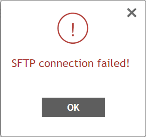

I'm trying to get SFTP working with vSmartZone.  I thought I might have fat fingered a setting, but not knowing what that would be, and deleted the VM of vSZ and reload.  I get the same error message on a fresh install.  the message reads:
SFTP connection failed!
Image_ images_messages_5f91c3f4135b77e2478f8fd2_3f08428f4fd01164902ad1f72976858a_RackMultipart20200430303761ggb-d683fec9-8166-4a34-90f9-b43eab02b94c-1566113106.PNG1588290196

Hi John,
Could you confirm what is the vSZ version?
There is a known issue (documented in KBA https://support.ruckuswireless.com/articles/000009415 ) on 5.1.1 version, which is fixed in 5.1.2
If your vSZ is running on 5.1.1 then please upgrade it to 5.1.2.0.302 and test.

BTW, any help from the knowledge base is not accessible.  The web site is not working.  Just get message stating "We're sorry, but something went wrong. We've been notified about this issue and we'll take a look at it shortly."  That has been there for a few days.
Hi John,
5.2.0 is the latest version.
Could you check and make sure there is no network related issues (port block on firewall, etc.).
If everything looks good, please log a support case for the investigation.
