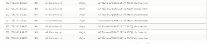

APs are now in the WLC. However, there's a 30-second disconnection continuously occurring. They come online and go offline. Also I'm unable to see the APs broadcasting the SSIDs (I've turned on the radios).

Dear @rajivw ,
Please to ssh into one of the AP try to ping the gateway of the AP and the controller, to see if there is any connectivity issues.
Regarding APs not broadcasting please ssh into AP and run "show wlanlist", you will able to see if the SSIDs are being broadcasted or not.

Abilash, this was resolved. Thanks again for the continuous support.
