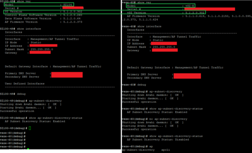

I have checked this internally and on my lab setup.
AP subnet discovery is supported on both SZ and vSZ. Command is also same and below it the output from my lab setup.
*Click on the image to see in full size.
