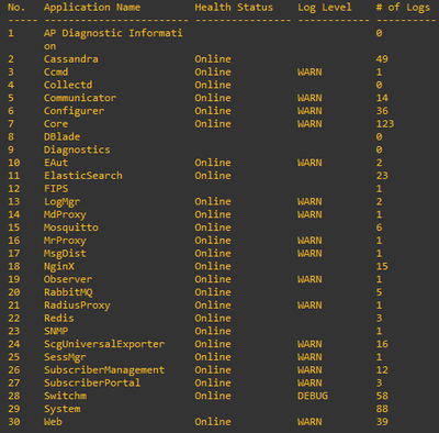

1.vSZ#show service

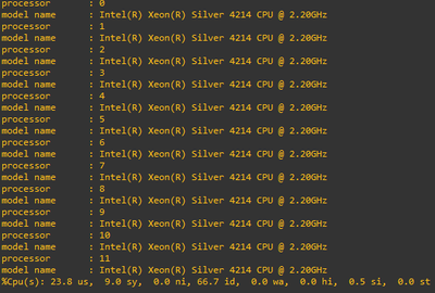

4.vSZ#show cpuinfo

SMARTZONE CONTROLLER
1.vSZ#show service

3.vSZ#show system-capacity
4.vSZ#show cpuinfo
