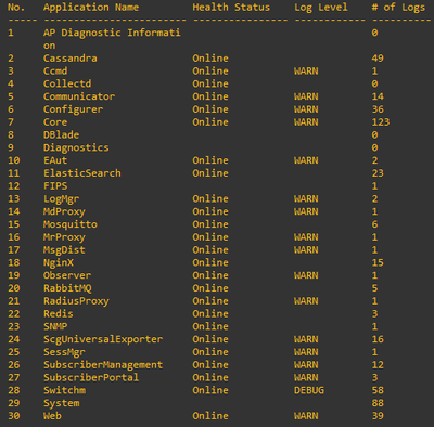

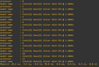

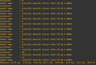

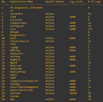

SMARTZONE CONTROLLER
1.vSZ#show service
2.vSZ#show version
3.vSZ#show system-capacity
4.vSZ#show cpuinfo
5.vSZ#show diskinfo
6.vSZ#show meminfo
