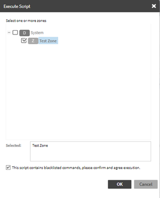

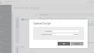

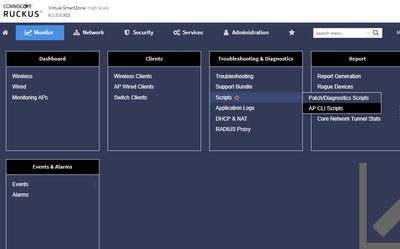

Login into the controller Web UI. Upload the Script under Monitor -> Troubleshooting & Diagnostics -> Scripts -> AP CLI Scripts
Click on Upload and assign any name under the script name, and select the .txt file saved on your PC.

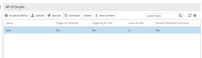

After uploading the script the script will show up under the scripts.
Click on Execute, choose the Zone and select the bottom option and all the APs under that Zone will be rebooted.
You can verify if the script was executed by selecting and click on View Execution Summary like below.
