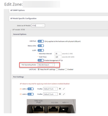

The problem come from the power mode that doesn't detect the UPOE and stay in AT with not working functionalities
setting the power mode manually and setting additional config to the ap on the zone fix the problem :
set power-mode AT
or for UPOE : set power-mode bt5
Thanks all for your help, hope this will help others
