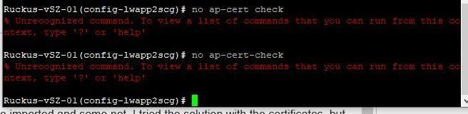

06-23-2023 02:38 AM
06-23-2023 05:53 AM
Hi @pluto09 ,
I see that you didn't exit out of the lwapp2scg.
After executing the below, request you exit and enter save and then proceed with "no ap-cert check" command
vSZ(config-lwapp2scg)# policy accept-all
vSZ(config-lwapp2scg)# exit
Do you want to update this context configuration (or input 'no' to cancel)? [yes/no] yes
followed by command
vSZ(config)# no ap-cert-check
Do you want to continue to disable (or input 'no' to cancel)? [yes/no] yes
Successful operation
Thank you!
