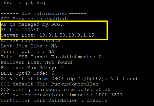

If you are not seeing the AP list under the Access Points tab, ensure that the APs are properly connected to the controller.
Login to the AP CLI (SSH) and check if the AP is connected to the controller. You should see similar output as below, where is should say "AP is managed by SCG", State : Tunnel or RUN, Server List : Controller IP address.
If you are seeing the similar details, then check in the SZ CLI to see if the APs are connected:
  • show zone "<Name of the zone inside Quotes>" ap
If you see the output on the CLI, then it could be that the GUI is not refreshed yet, use the below command on the controller which will refresh the GUI.
