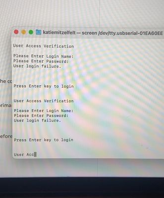

01-09-2023 04:37 PM
im not sure if I am able to send you a video, but this is the screen which keeps scrolling through very fast over and over
01-10-2023 09:27 AM
Hope you are doing well!
Based on the troubleshooting done, since you are not able to access via CLI since is scrolling down over , this unit Should be RMA (return merchandise authorization) in simple words replace it.

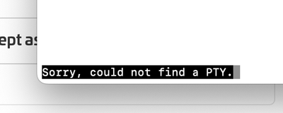

01-09-2023 04:49 PM
I tried again... this is what I am typing to terminal....
screen /dev/tty.usbserial-01EA60EE
and this is the error I get..
