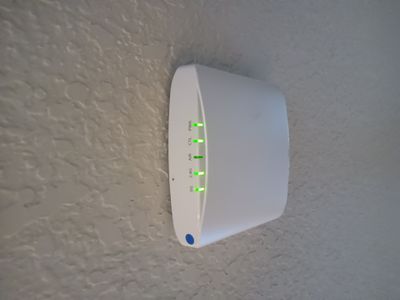

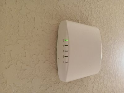

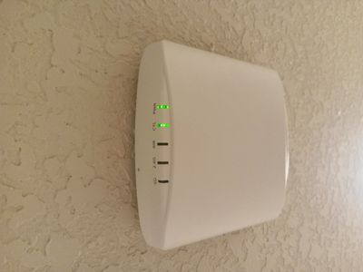

The status of APs are the same as before:
1. Master AP (which has Wi-Fi network set up) has 4 lights on and solid
2. The one that needs to find and extend the network has two lights, one is solid and one is blinking:

Hi @Sergy
Could you kindly disconnect and then reconnect the second AP about three times to check if it can successfully join your existing network?
11-02-2023 01:53 PM
Hello Sofia,
It was a few days since I updated the log with my issues.
The last several days I was disconnecting and reconnecting the second AP from the switch, so it would find the existing Wi-Fi, connect, and extend it for the whole house. But it does not do that. It gets stuck on broadcasting the "Configure-me..." network even after resetting this specific AP unit.
