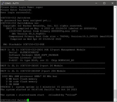

Hi @Sergy
Could you help me with the show version command?  How are the APs lights now? Green, blinking, static, red?

3. Regarding the switch version, please see this screenshot:
