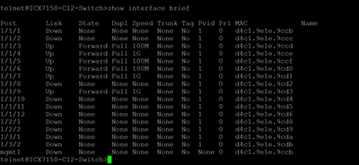

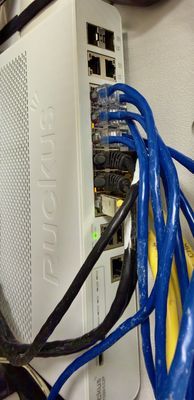

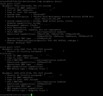

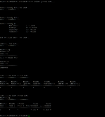

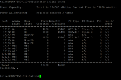

Hi, I was able to upload the picture as you can see above. I tried changing the cables to different ports. But each time, The switch/APs drop after about an hour or so and I need to switch off and restart the CX7150. This has been happening past one month. Even after I reboot the system, the speed I get on my wifi is very low with my one gig internet connection. I tested the speed at the Input to switch shows 1 GBPS. Does it require any version update? or any repair? I need this fixed ASAP please. Your responses are pretty slow.
