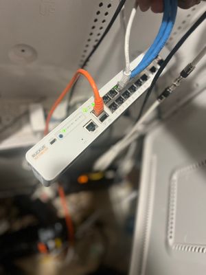

I am hoping you can please help me. I have spent the last three days going through your website trying to figure out was is wrong with my cx7150 to no luck. Please let me explain. two years ago i replace my cx7150, or (RMA) . Another unit was sent out, at that time I couldn't figure how to set it up. so i  never use it. Recently I thought i would try again to set it up, but not able to again. I am disable and i truly having the hardest time with this. I WOULD love to use this system one day. please help.

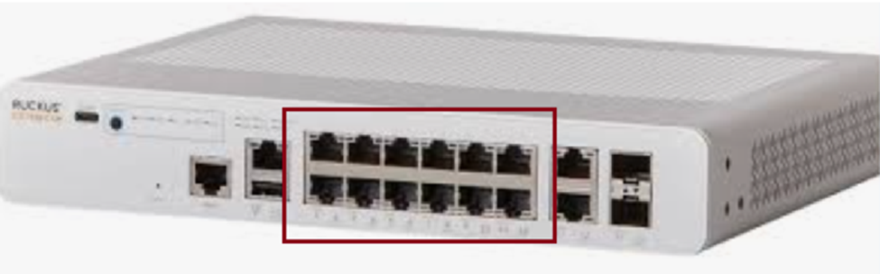

From the pictures you shared, it seems like the ethernet cable which is coming from the ISP’s (Internet Service Provider’s) Router or Modem/Router combo is plugged into the wrong port on the Switch panel. It must be plugged into any 1 in-12 ports as shown in the below screenshot.
1. Please unplug the ethernet cable and plug it into the correct port then reboot (unplug and plug from the power outlet) and try to connect to the Internet via Access Points.
It should be plugged into one of the 12 ports as shown in the below screenshot.
