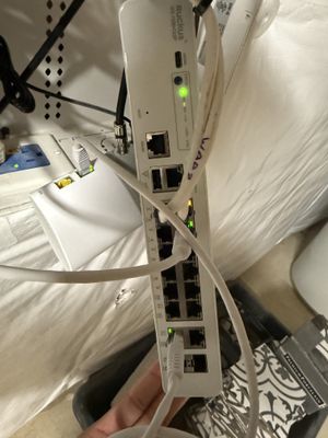

I have two Ap but only reset one r510 APs and set everything up including a ssid and password but for some reason I still cant get wireless connection. I went and connected it to the main moteum and that worked perfectly but when I tried to connect it to the ruckus motem that sends the signal to the APS I could not get any signal via Ethernet. Annythign that im missing here?

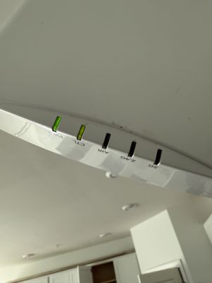

and then the above photo the pwr light is blinking green. and ctl is solid green. i got it to show the amber on 5gnand 2.4g to turn on but for some reason whenever I tried to connect to ssid I can see it trying to connect but no internet is getting connected.

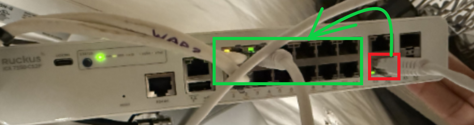

Based on the picture you shared, it appears that the cable from your Internet Service Provider’s (ISP) router or Access Point is connected to the incorrect port on the RUCKUS ICX-7150-C12P Switch. The cable should be connected to one of the 1-12 ports on the switch (please refer to the screenshots below). Kindly unplug the cable and reconnect it to the appropriate port. Afterward, please reboot the ISP router by unplugging and plugging it back into the power outlet. Once done, check your internet connection.
Please let me know how it goes, and feel free to reach out if further assistance is needed.
