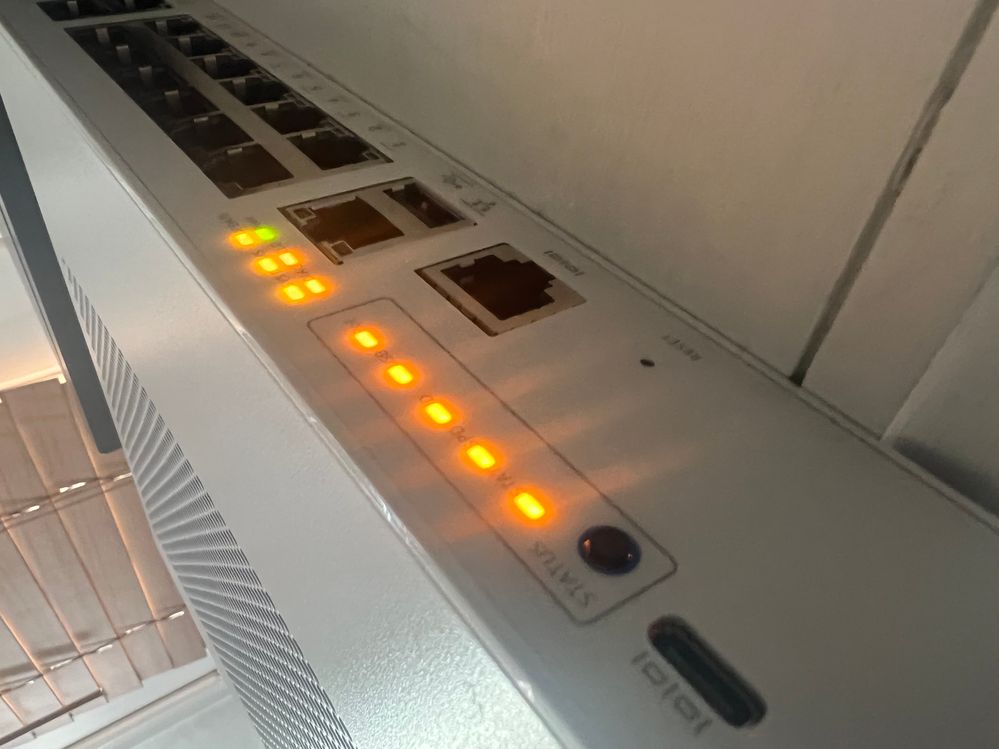

Valued Contributor III
Hi @savovcm
Please share the error you are getting while performing software recovery. Also please share the logs from the software recovery of the switch.
