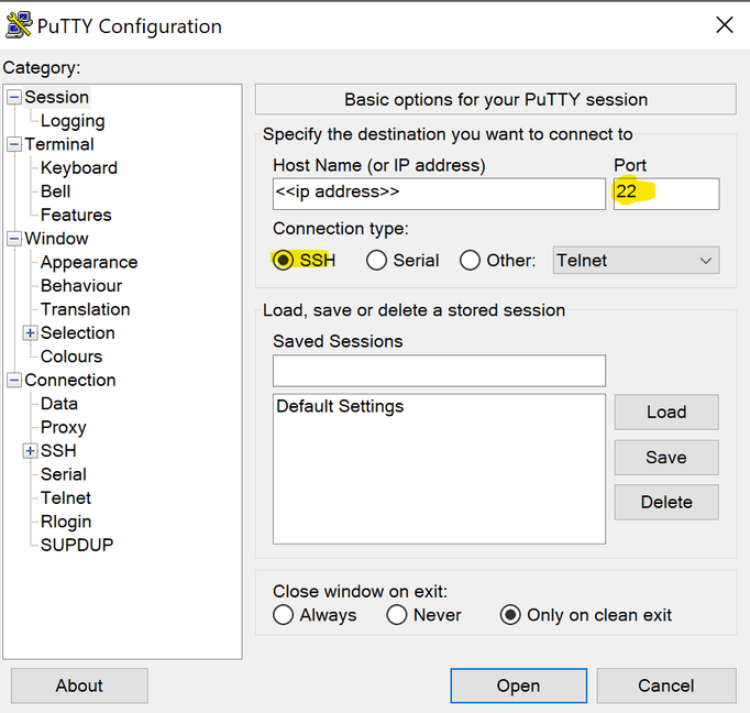

Hi vrizzo
Thank you for the response and update.
Please check the port number. And also try the Telnet option.
SSH- 22
Telnet - 23
If SSH or Telnet works, please login with default credentials with the combination as shown below:
If telnet access/ssh access is not working sometimes a hard reboot (disconnect and connect the switch from the power outlet) works, but if that does not work, we need to access via the console as described in step number ‘4’ of the previous post.
And also, you could try the WEB access option as described in Point ‘3’ option II.
Try to access your switch from a web browser by pasting the below URL.
https://192.168.1.66 or http://192.168.1.66
If this step does not work, we need to access the Switch via the Console as mentioned above (step number ‘4’ of the previous post)
