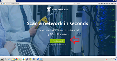

Using the following applications is possible to scan your network to check the IP address for Telnet/SSH or web access to the Ruckus devices.
Windows:
https://www.advanced-ip-scanner.com/

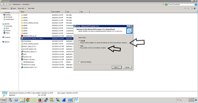

1 ) Downloads the application
2 ) Proceed to install (it can be portable ‘does not need to be install’ or install.exe that install the app in your computer)

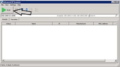

3 ) Once is installed (open the app) and then click the Start bottom to star running the scanner

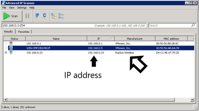

4 ) Ruckus devices are going to be detected as Ruckus Wireless / Ruckus Switch / Ruckus Router / unleashed as the shown example:
Video link as reference: https://www.youtube.com/watch?v=0zxgUn_Tm08

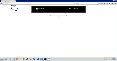

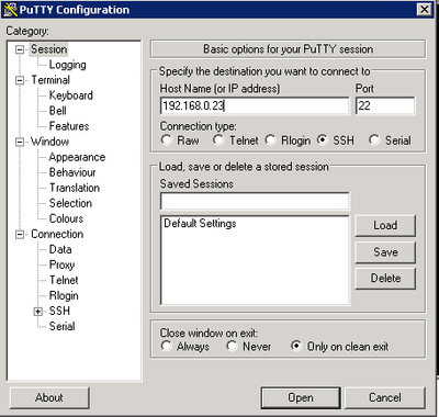

5 ) Since we already know the IP for the Ruckus switch (192.168.0.23) , I can access to the switch via Web/ssh/telnet
Webb access example :

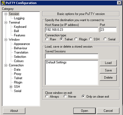

SSH example:
Telnet example :
