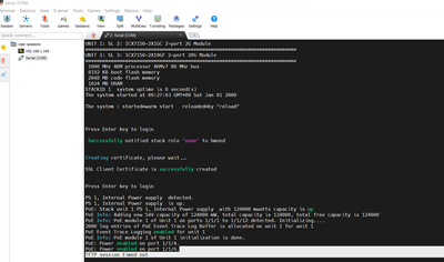

11-10-2022 08:07 PM
I do all that. It works and then eventually times out. Any help.

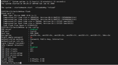

Hi @PeterK !
Can you log in and run the following commands copy and past it here :
show flash
show version
show ip ssh config
What you mean times out ' TFTP time out ' ?

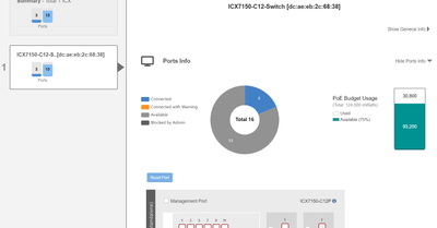

11-11-2022 07:37 AM
It's saying "ICX7150-C12-Switch" and "SPS08090d" now. Holy **bleep**ing **bleep** I think I did it.
If the dashboard switch looks like this, it means it's fixed right? Is there anything else I need to do?

Most of the time adding the ICX - 7150-C12p to the unleash dashboard takes some time as it is necessary to exchange databases or data between access points and ICX in order to sync the information.
Great to see you did ! Nothing to do on your end !
