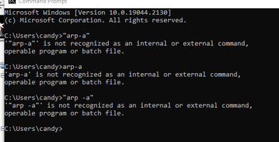

11-11-2022 12:43 PM
here is what happens when i try to run that. I have tried this method before from your earlier one.
