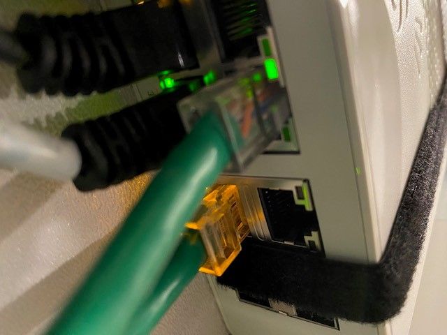

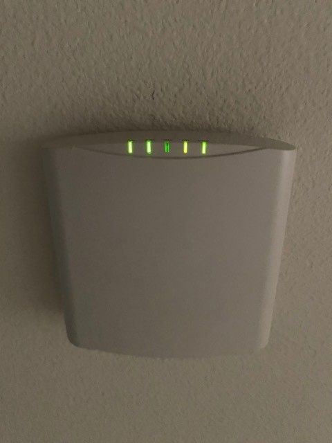

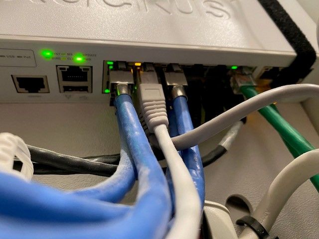

Hi again - Here are the pics or our setup with the Ruckus switch and the two AP. The main issue we think is with the AP on the 3rd floor. The internet signal is horrible up there and that is where I mainly work every day. Please advise if you see something wrong with the setup. Please note in Pic #3 one orange light where the grey chord is going into. That chord goes into the router. Thank you!

Based on the images you have shared it seems like the cables are connected properly and the LED status of the switch is good.
